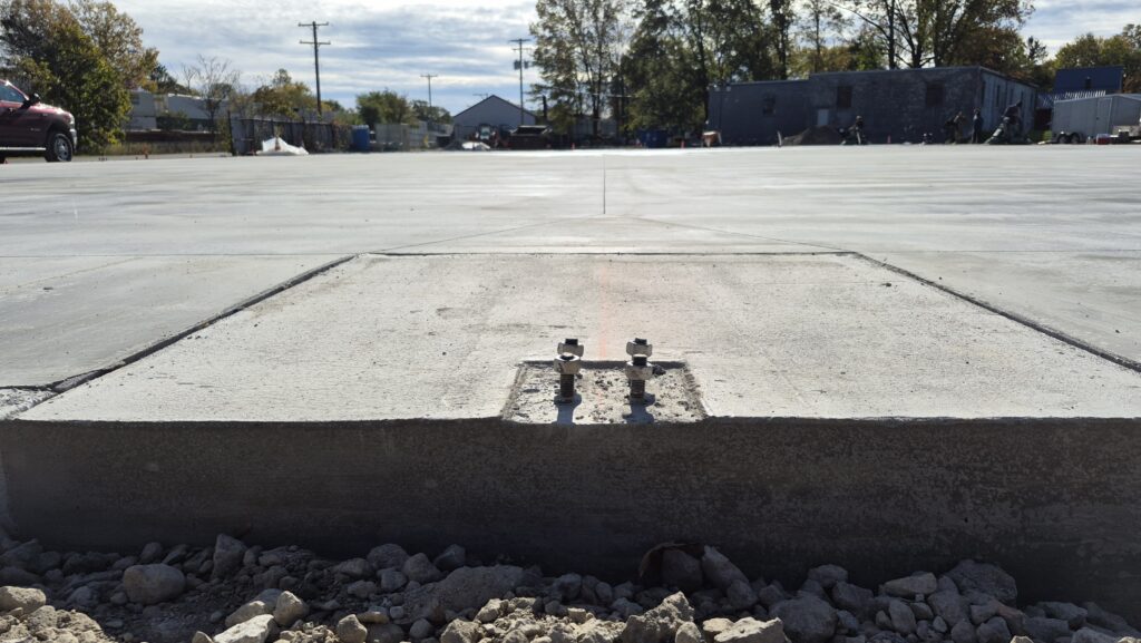

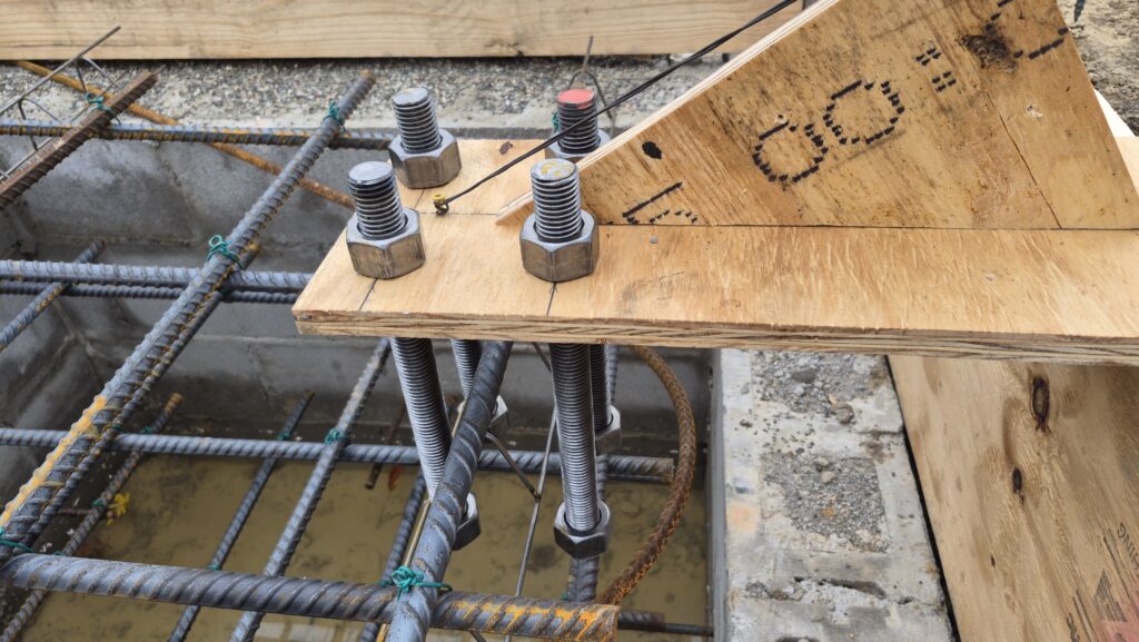

We began by setting thirty concrete pylons that will carry the building’s steel frame. Each pylon used a removable template to suspend four threaded anchor studs at precise elevations and bolt spacings; the pour buries most of each stud, and once cured the template lifts off, leaving perfectly aligned bolts ready for column base plates.
Those anchor rods conform to ASTM F1554 (Grades 36/55/105), the standard covering mechanical properties and thread classes for structural anchor bolts — the quiet heroes that transfer column loads into the foundation. The pylons alone consumed 50 cubic yards of concrete, setting the stage—quite literally—for what was to come. The floor.

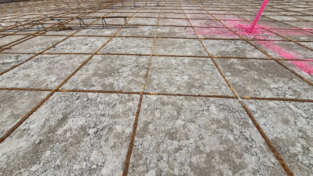

The main slab spans 18,000 sq ft at 6 in thick, which is 333 yd³ for the full floor. We poured it in two halves over two days to keep placements and finishing in the sweet spot. Under the slab is a compacted stone base topped by a rebar grid to improve load distribution and crack control. This will allow 10 ton forklifts to safely maneuver without concern of damage or stress.

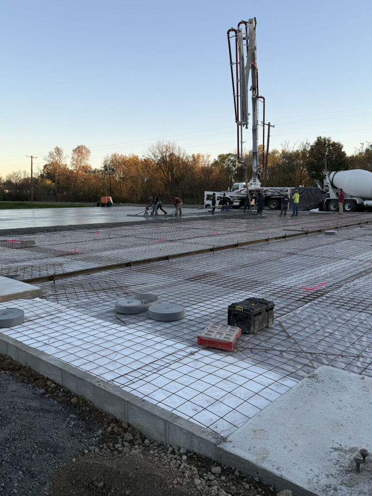

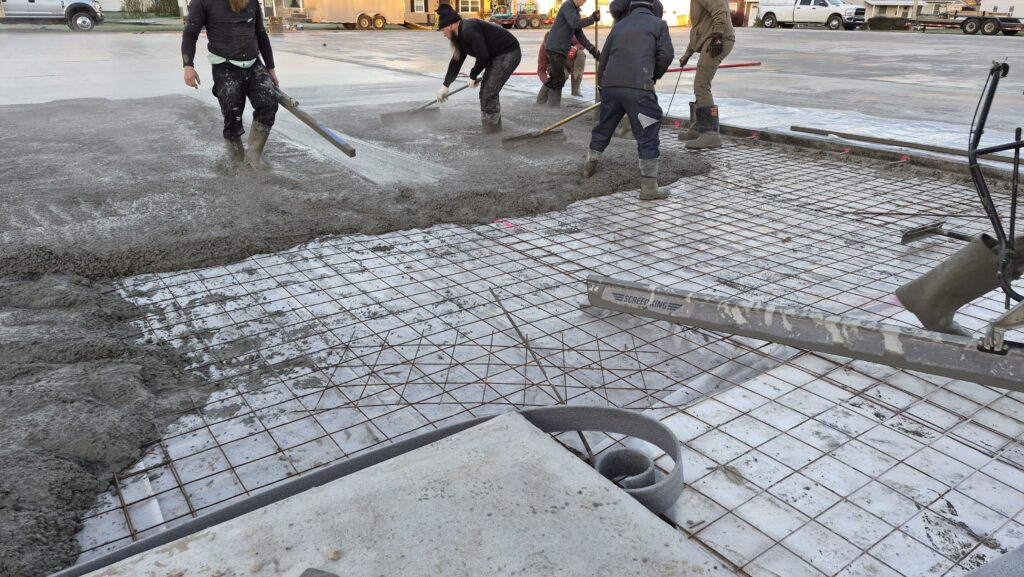

The same towering boom truck mentioned in the previous blog post is now in action, its long, jointed arm stretching out like a steel mantis over the freshly prepared grid of rebar and vapor barrier.
In the foreground, you can see the clean white foam and plastic vapor barrier and steel mesh waiting for the next section to be poured, while farther back, the crew works the fresh concrete with screeds and floats, leveling and smoothing the surface as dawn light breaks across the site. The pumper’s boom feeds a continuous gray ribbon of mix across the slab, reaching areas a chute could never access directly — a necessity for a pour of this scale.
The ready-mix truck keeps the hopper fed, while the pumper operator controls the hydraulic arm with pinpoint precision. The early morning sun, the mist of fresh concrete, and the steady rhythm of the crew mark the moment when months of groundwork finally start transforming into solid structure.

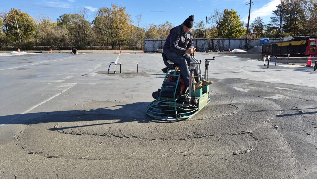

Early morning pumps delivered the concrete, crews screeded and struck off the surface, and soon after electric power trowels began their work.
These machines deserve a moment of attention—they’re not your average slab-finishing tool. Ride-on power trowels are large machines with twin rotors, wide spread blades, and high horsepower engines. Some models weigh close to 1,200 pounds or more. Speeds can exceed 150 rpm in the blade system. A single ride-on unit covers what multiple walk-behind machines would, which is exactly why the crew used them—to maintain flatness and finish over such a large slab in a timely manner.
